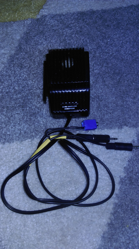

Cobbled this together with parts from my junkbox. The casing is an old noise cancelling mic. The lead is from an old pair of headphones. A condenser mic i had laid about and a few jack plugs. Its not a speaker mic. I have added a 3.5mm socket to plug in an extension speaker. As it will only be used for homebase use.
I could have bought a speaker mic for a fiver. But i enjoy making stuff and already had the parts..How does it sound ? Not tried it on air yet. Probably like I'm upside down in a wheelie bin full of water :lol:

I like your fluffy rug :thumbup:
