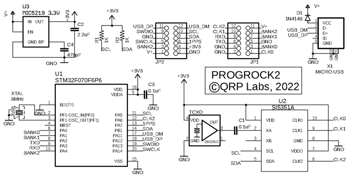

Why not try a progrock2 it can have 3 independant frequencies and can be GPS locked but thats only if you need 2 frequencies.
https://qrp-labs.com/progrock2.html

Progrock 2 won't work in this application - 3 reasons:
1) No analog input
This is needed in order for the clarifier to work. The clarifier varactor voltage will have no effect on the Progrock2 module, which means the clarifier control(s) will no longer function.
2) Not enough frequencies selectable
Progrock2 can be configured with either 2 or 3 selectable frequencies. He wanted at least Lo-Mid-Hi and there is an offset needed for LSB to operate, so a minimum of 6 frequencies will need to be selectable. For Super Low / Low / Mid / High / Super High you will need 10 frequencies selectable. If he wants a +10KHz shifter too, he will need 20.
3) Degraded radio performance
The output of the Progrock2 is noisy, 20dB to 30dB higher than a crystal oscillator, with low level spurs a meg each side. Won't affect a digital circuit... but because the oscillator mixes up to become the local oscillator in the radio, the noise and spurs will appear in the receiver. The user will notice the radio picks up more background noise and that it is more susceptible to "splatter" interference from strong stations on other channels due to them mixing with the spurs and appearing in the IF passband (and hence the received audio) of the radio it is installed into.
We used Progrocks and SiLabs synths in work we've done in the last few years - but only in Uniden and RCI chassis (not Cybernets) - in those chassis, the added oscillators are only used to lock the loop (i.e. digital), their local oscillators separated from the PLL downmix by a low pass filter with a cutoff of only a few KHz, so no noise or spurs enters the radios analog circuitry.
1) No analog input
